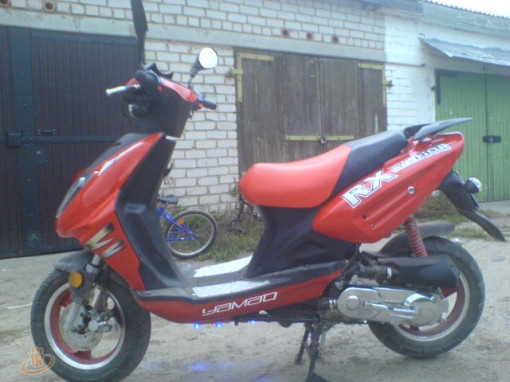

Hello, I'll write in English, but you can answer in Russian language, I understand it, I just can't write in it.
So here are my Yamati when I bought it :
STR8 risser kit:
My 60w sound system:
Now I've installed:
naraku HS vario
BGM pro 75ccm
Naraku CDI
but I can't find any carburator ~21 or 24mm, maybe you can help me find it
Now I've little problems with money, but I think in 1 month my scooter will be ready, I'll put many styling thinks inside, like sport handlebars, sport back and much more...
And in engine, well my target is fastest 4stroke scooter in Latvia, so I'll do anything to reach it :D
Naraku HS vario
BGM pro 75ccm
Naraku CDI
and it's just beginning...
