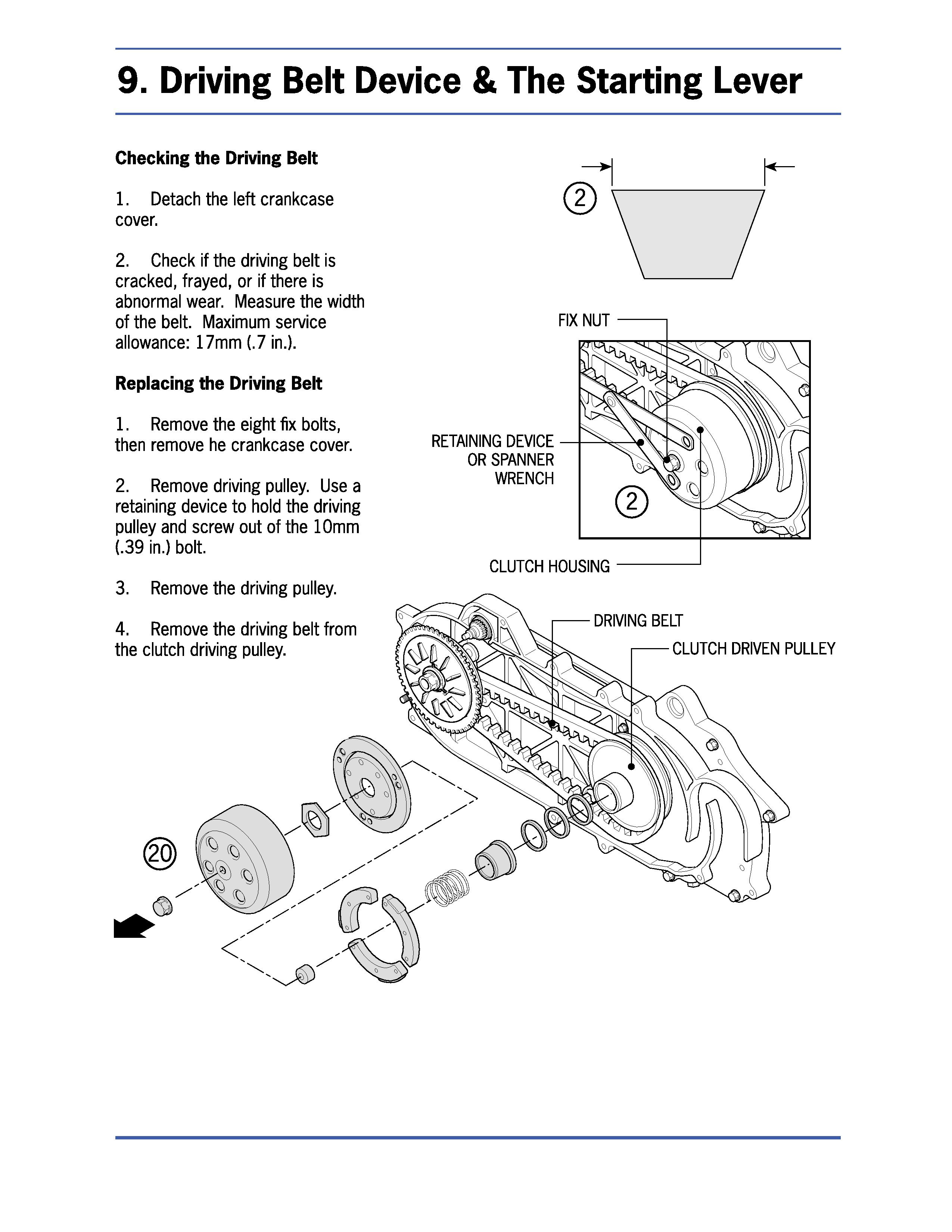

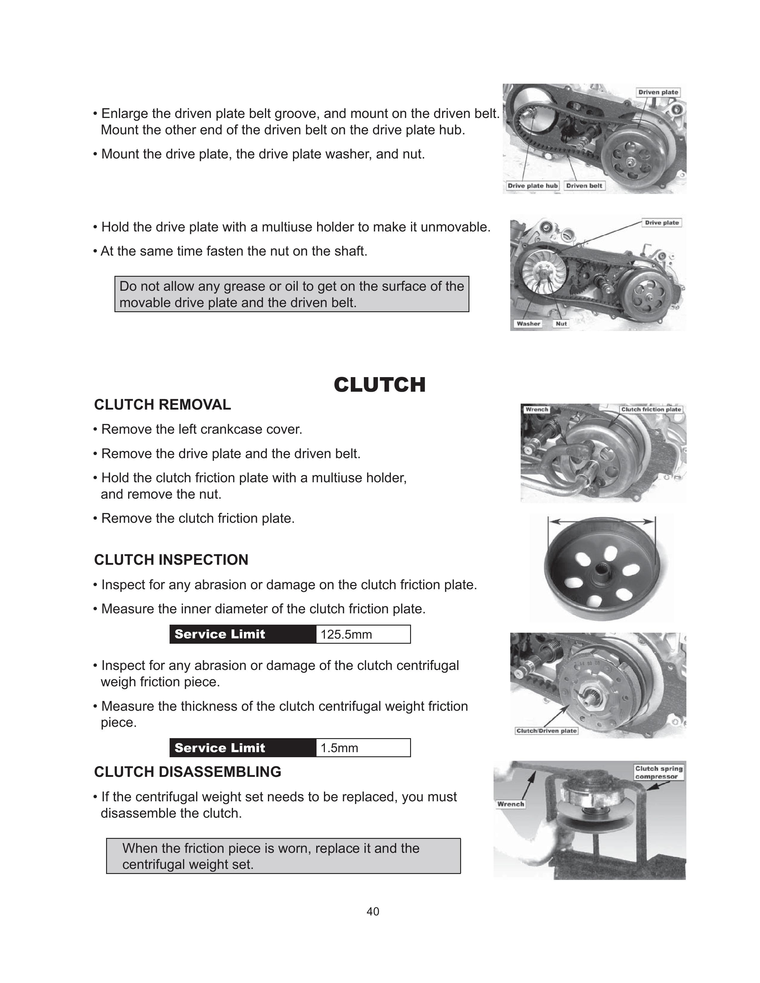

download/file.php?id=27115&mode=view
download/file.php?id=26988&mode=view
